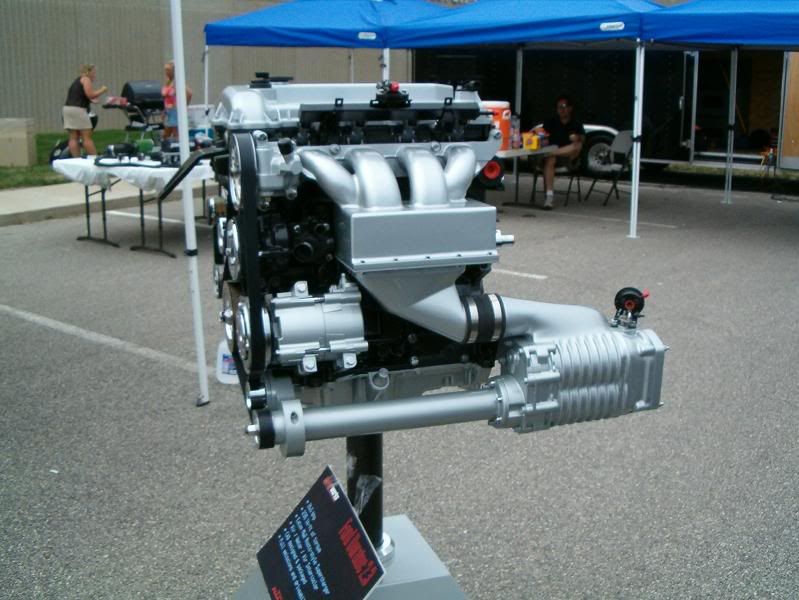

cant_focus wrote:There is a post on FJ somewhere about a duratec that was supercharged...I can't remember who did it, but it made 250whp and 240tq i think?
Yup,
Iv'e seen that, it's a prototype, too bad they never offered it as a kit, pretty cool, gotta love that looonnnggg snout. The plan in my head is to move the SC forward on the block to where the A/C pump is and turn the case so the outlet faces towards the front of the car. In the picture, all the plumbing from the SC's outlet to the boxed plenum would not exist as the outlet discharge would be routed forward and around the radiator on the passenger side, infront of the radiator, and back around the drivers side up to the plenum box, with the incoming charge entering the drivers side of the plenum instead of below the plenum. With the SC moved forward on the block it gives me the ability to place the TB in a near stock position and route the SC's inlet tubing to it. I'd be happy with the numbers that kit put out.....
