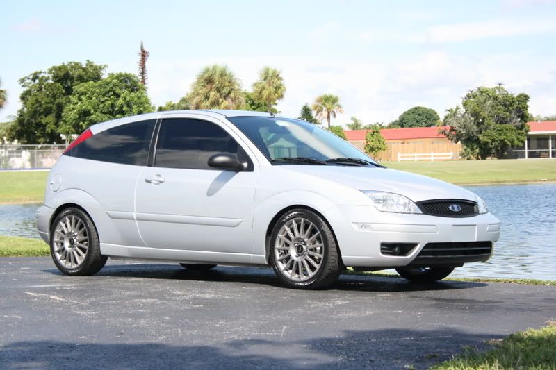

Well here is a guy running the tokico HP's and sportlines...

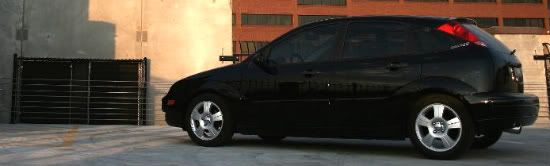

Heres mine with the FRPP 1.5". I really wish I would have gotten pictures of it with my TD's on it, it looks so much better.
Looks like I found my set-up. He replied quite fast and He never rubs. Has the camber bolts, and i'm not sure what else... Talking with him now..
ALRIGHT! Looks to me like I found the right stuff. I was talking to this guy on [FJ] for about 20 minutes finding out his set-up, and figured out it's about the best I can get. The whole shebang will cost me about $600.
