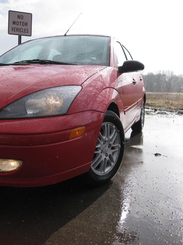

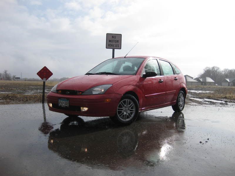

This is my car. It's stock in these pics. Right now all I've put on it is my AEM SRI. Trying to decide what to do next.

oooh, 5 door
