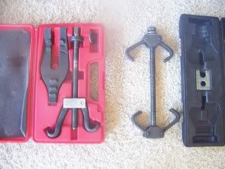

Get the one from Autozone if you have one near you. The bottom part of the compressor is flat as opposed to flexible which allows it to start farther apart on the coil. The LCA bolt would have been nice, but there was no getting it out. Only wish I woulda figured it out sooner. Give the LCA a shot but don't even start without the spring compressor handy. If you don't have an Autozone near you, you want to try to find the one on the left, not the right. You'll still need to make a spacer, about 3/4" ID pipe by 4" long. Set the included washer on top of the spacer. When you reinstall the new one, there's a rubber sleeve toward one end of the coil. I talked to Steve and he looked it up for me, that sleeve goes toward the top. Also be sure to tape the top mounting donut to the spring itself. Will save a little cussing. Good luck, It should take you about 4 hours to do all four corners, but will probably take much, much longer. :( Start early!
