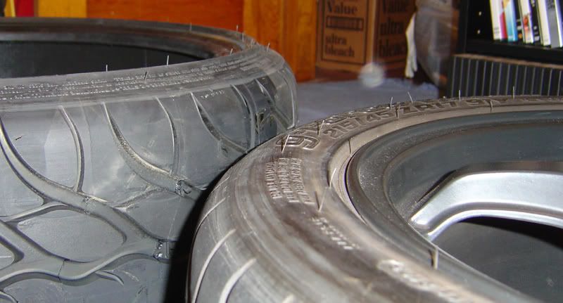

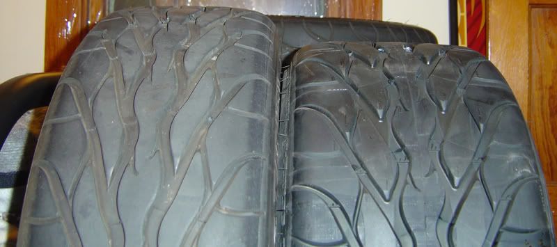

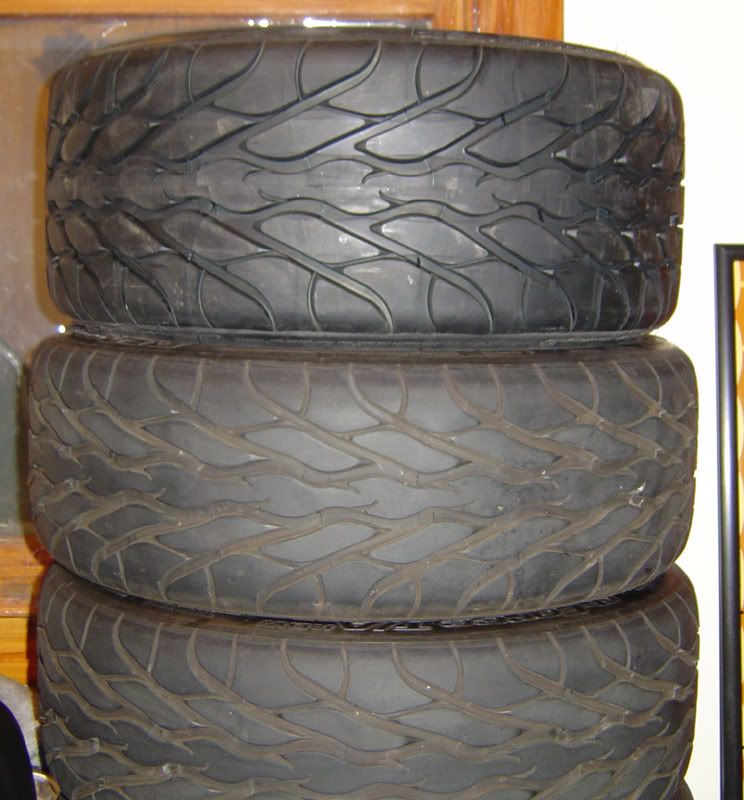

Ban Happy Zero wanted to see the tyres(see Nick, I'm so German, I type like them LOL)
Last years rims and tyres on bottom, new hotness on top....
Height difference
Width Difference

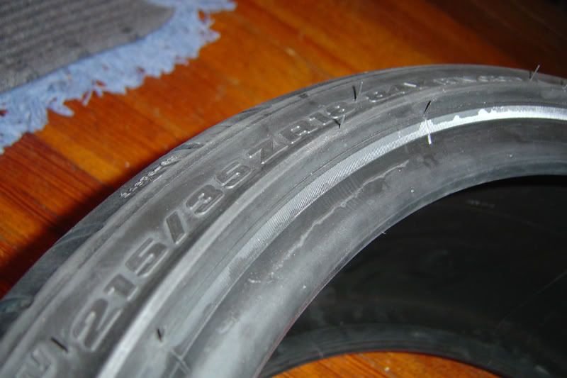

And the size...

Those 215/35 looks wider than the old 215/45. Or am I seeing things?
Yeah, thats what I was trying to explain last night. For some reason, BFG makes two difference 215 widths...LOL

Here are what the spec differences should be. By the looks of the new skins, they won't fit the Focus. Weird
Stock Tire - 215/45R17 =================Tire 215/35R18
Section Width: 8.46 in 215 mm ============Section Width: 8.46 in 215 mm
Rim Diameter: 17 in 431.8 mm ============Rim Diameter: 18 in 457.2 mm
Rim Width Range: 7 - 8 in ===============Rim Width Range: 7 - 8.5 in =
Overall Diameter: 24.61 in 625.09 mm ======Overall Diameter: 23.92 in 607.56 mm
Sidewall Height: 3.80 in 96.52 mm =========Sidewall Height: 2.96 in 75.184 mm
Radius: 12.30 in 312.42 mm =============Radius: 11.96 in 303.78 mm
Circumference: 77.31 in 1963.6 mm ========Circumference: 75.14 in 1908.5 mm
Revs per Mile: 845.1 ==================Revs per Mile: 869.5
Actual Speed: 60 mph 100 km/h ==========Speedometer1: 61.7 mph 102. km/h
Speedometer Difference: ==============Speedometer Difference: 2.887% too fast
Diameter Difference: =================Diameter Difference: 2.81%

o2designs wrote: Yeah, thats what I was trying to explain last night. For some reason, BFG makes two difference 215 widths...LOL
I don't remember exactly how it works but the 215 and 35 work in proportion to each other so it actually does make sense that they would be different widths.

Rog at The Tire Rack says its the exact size to run for my rim size and susp. Apparently the 18s really mushroom up when mounted. Which pisses me off, I wanted alittle Euro Stretch, but sounds like that won't be happening...LOL
And yeah, they'll prob rub. My current 17's rub anyway. So I already rolled the fenders, and the new rims don't have such an aggresive offset, so it'll push the tire back in.
o2designs wrote: Rog at The Tire Rack says its the exact size to run for my rim size and susp. Apparently the 18s really mushroom up when mounted. Which pisses me off, I wanted alittle Euro Stretch, but sounds like that won't be happening...LOL
